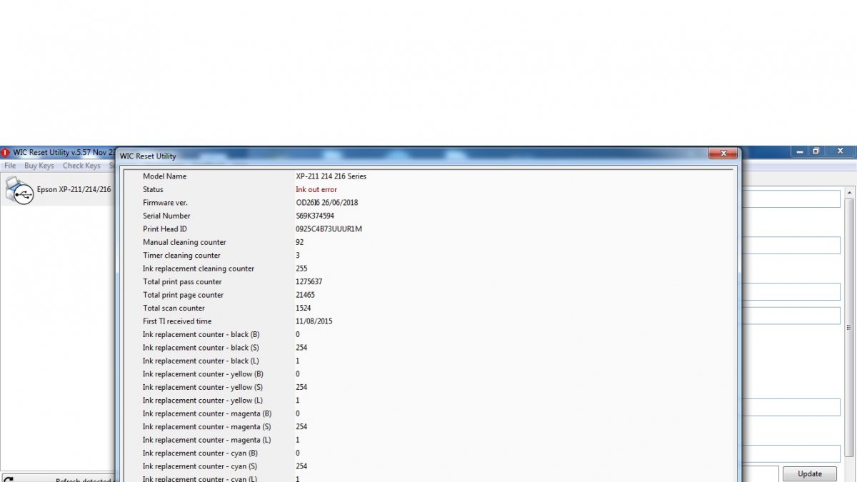

Post a screenshot from WIC with the current firmware version. Also, if you send me contact information in PM (skype, telegram) I can connect to you remotely and check myself.

Good day. Did you have recognized ink cartridges during update process? Your screenshot is shown ink out error. This model will not accept new firmware correctly in the normal mode if printer is not able to print.
