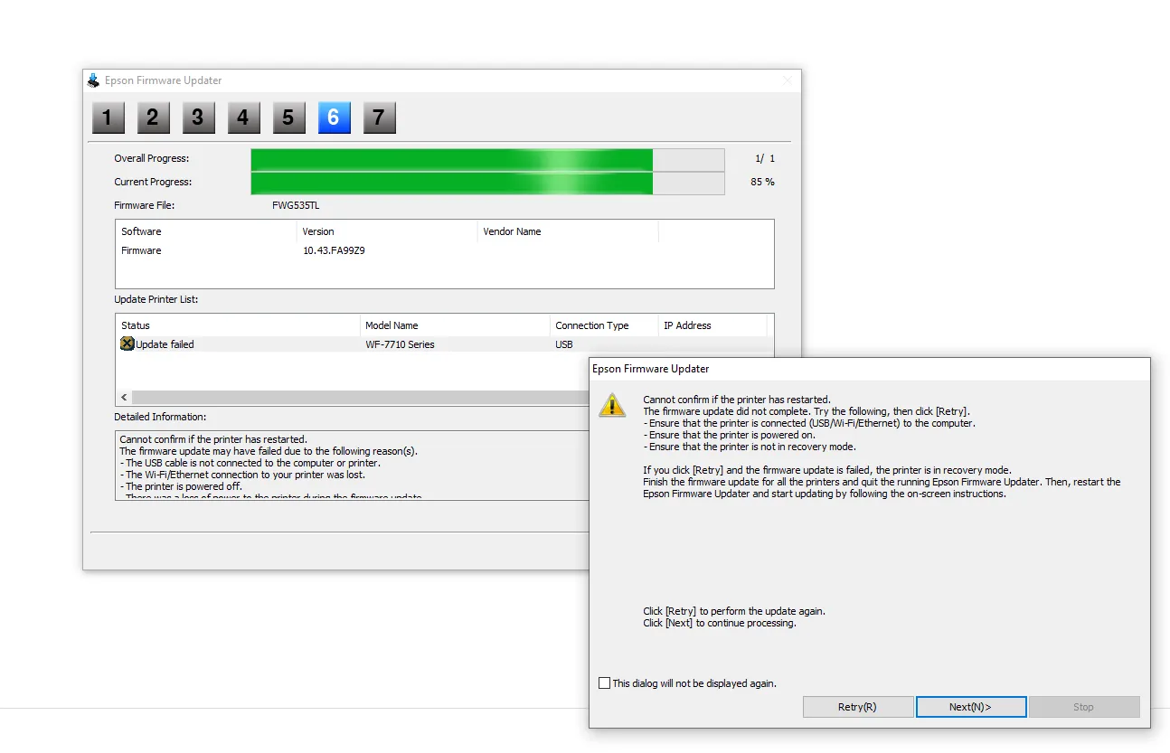

Dawko 0 Report post Posted December 18, 2021 Any ideas? Thanks received_233128142228574.webp Share this post Link to post Share on other sites
John_Admin 393 Report post Posted December 18, 2021 When Firmware Update process is complete - printer will restart - usually it will take only a few minutes but can continue for 10-20 minutes in some rare cases. If process hangs or stops at 80-99% - replug power cable and start printer manually.Now check current firmware version ( how to check). If firmware version is FA24I5 - firmware has been uploaded successfully. You can go to next Step. If NO - restart the printer and try once more time. Share this post Link to post Share on other sites
John_Admin 393 Report post Posted January 4, 2022 Have you done all Steps? Share this post Link to post Share on other sites
