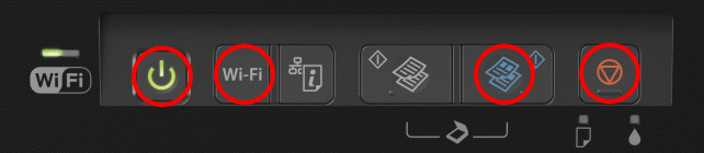

Epson XP-211, XP-212, XP-213, XP-214, XP-216, PX-046A
XP-230, XP-231, PX-048A
Press and hold:
XP-211, XP-212, XP-213, XP-214, XP-216, PX-046A chipless firmware
STOP + COLOR + WIFi + POWER – wait until all LEDs except Power LED is ON - then Release all buttons.
That means printer is in Firmware Update mode.
If indication differs - that is wrong mode. Try once more time.
Next Step - Upload Firmware to printer.
Run EPFWUPD.EXE file and follow all steps until Firmware will upload in printer.
After Firmware Update is finished - all LEDs will blink simultaneously – printer will go OFF.
Press STOP button - printer will  turn OFF.
Switch ON the printer. Printer will be in regular condition.
Note 1: If upload process stuck at 70-80% - You have to unplug printers power cable for 1 min and switch printer ON.
Confirm right firmware version is now in Your printer. Read how to check current firmware version here.
Note 2: If printer doesn't accept firmware - try to make it in Recovery Mode -  read how  HERE
Go back to main Guide to use Activation Key

Epson
XP-240, XP-241, PX-049A
XP-243, XP-245, XP-247
XP-255, XP-257
XP-2100, XP-2101, XP-2105, EW-052A
Press and hold:
xXP-240, XP-241, PX-049A chipless firmware

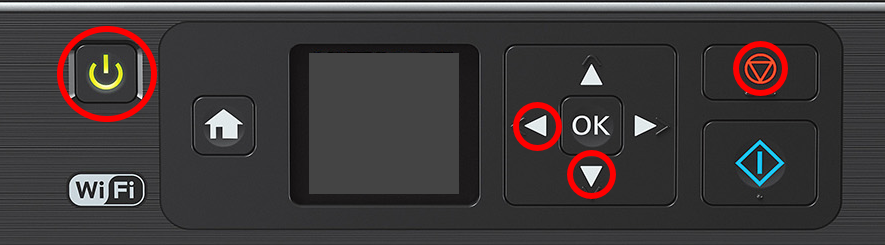

Epson
XP-340, XP-341
XP-342 XP-343 XP-345
XP-352, XP-355
XP-430, XP-431, XP-434
XP-440, XP-441
XP-3100, XP-3105, EW-452A
XP-4100 XP-4101 XP-4105
WF-7210, WF-7211 WF-7215, PX-S5080
Press and hold:
XP-340, XP-341 chipless firmware
STOP + LEFT ARROW + DOWN ARROW + POWER – wait until all LEDs except Power LED is ON - then Release all buttons.
