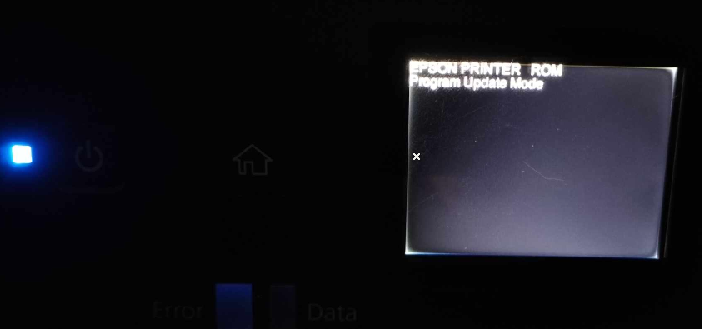

Is there a way to exit "Program Update Mode" I performed several Firmware Update - the old, the latest FW from Epson support website and the chipless firmware- but of no luck, I got the same status when I turn on the printer "Program Update Mode".

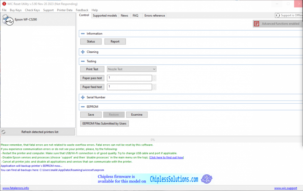

This is what I've done from this LCD screen every time I turned on the printer

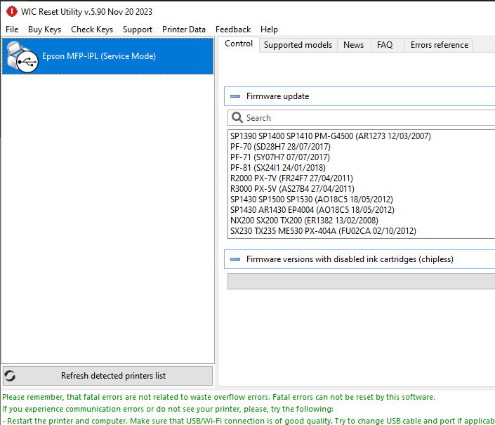

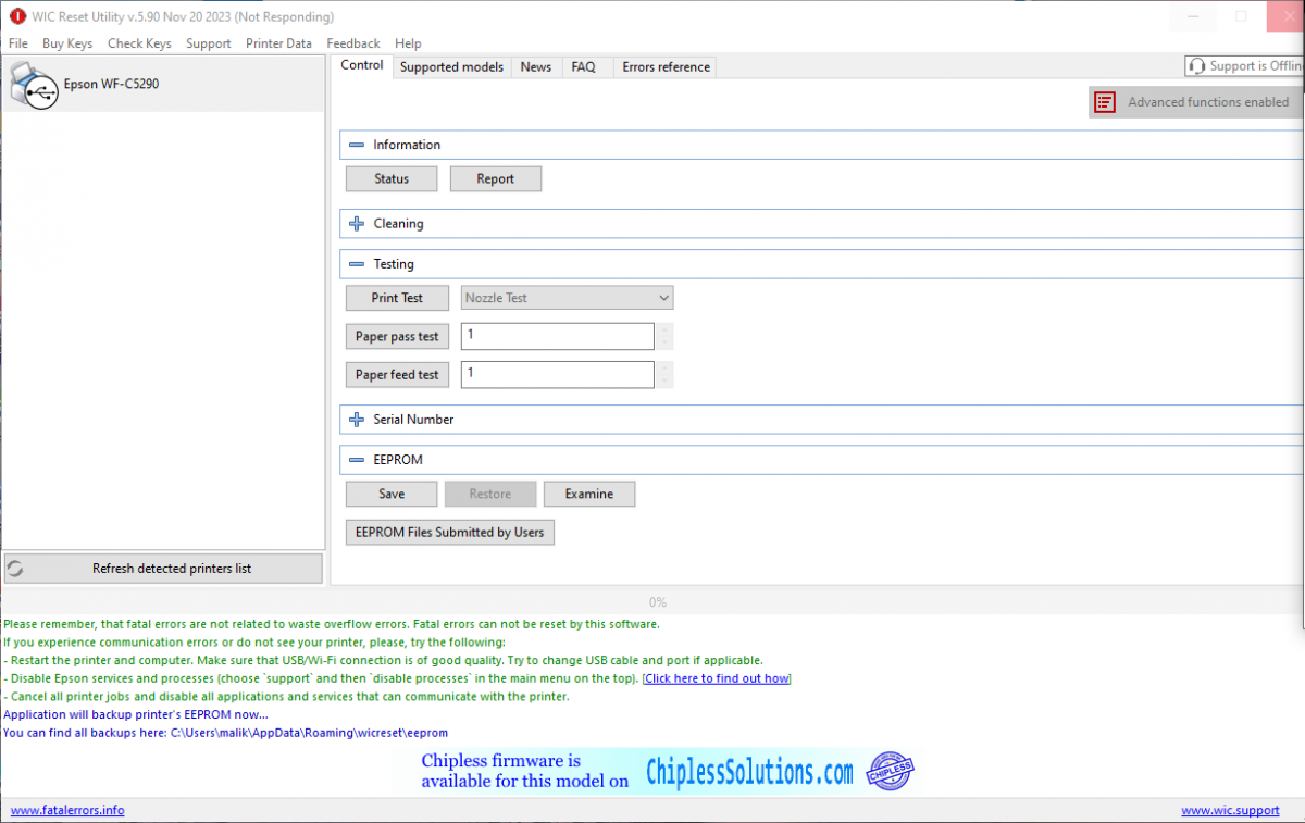

USB port detected on WIC software

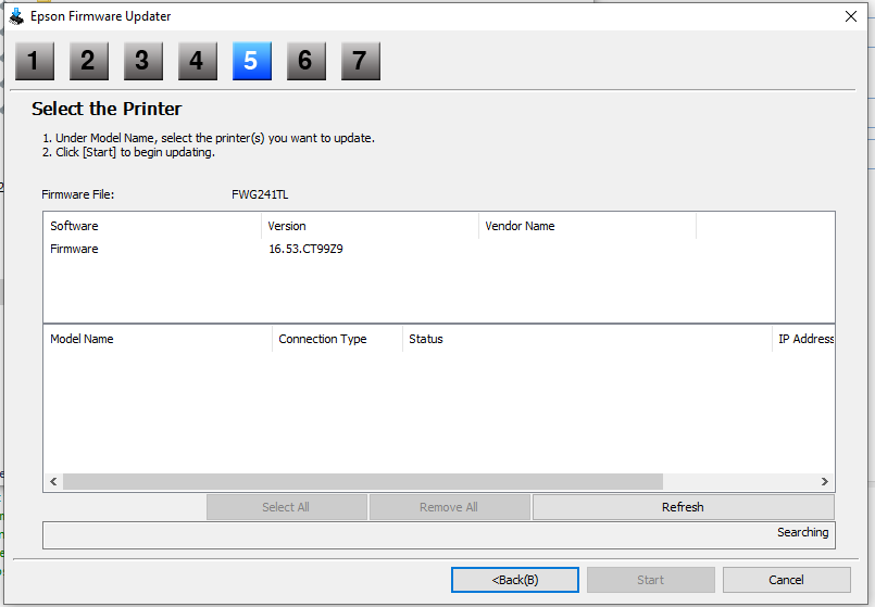

but not on Firmware Update software

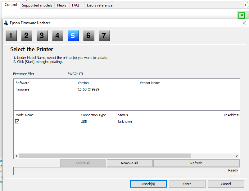

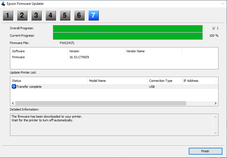

but if I press STOP+Arrow Down+Arrow Left+Power button the Firmware Software able to detect the USB port
then I can continue with the Firmware update

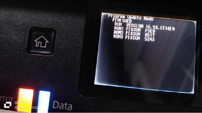

after finishing the update, this screen appeared with all lights blinking, then back to the start

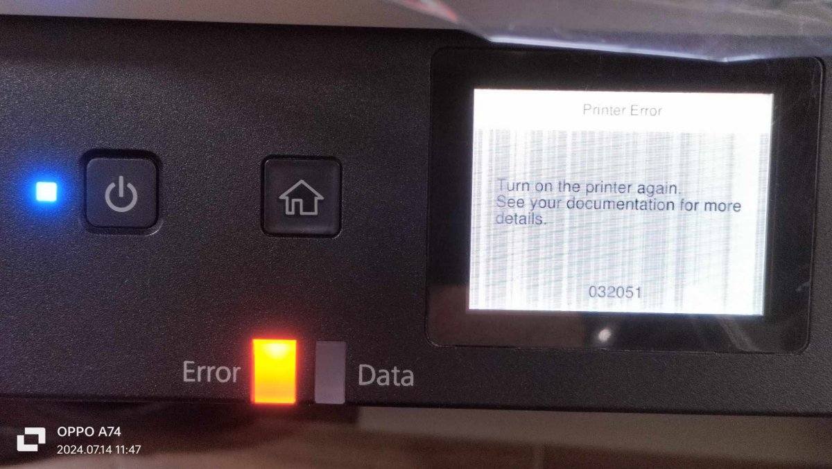

I also encountered the same problem as the author with my WF-C5290.
Epson Printer ROM - Program Update Mode appears on the screen.
No matter which method is used, the machine will display like this when it is turned on.

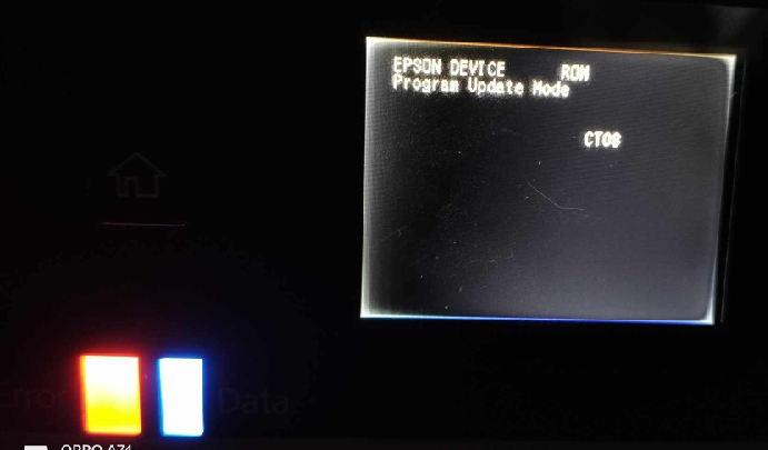

Finally the usb detected on normal mode with the screen printer display - Epson device rom program update mode -
I installed Epson  Software Updater and the time it connect and try to update the software I checked if the Firmware update software could detect the printer - it does.\
How ever the prior problem still exist. I'd try to update firmware to solve this problem.

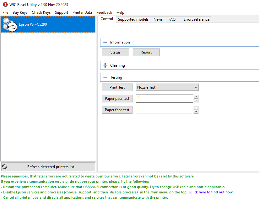

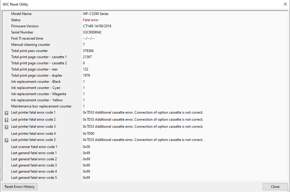

with this report on wic software
i restored the recovery key for chipless firmware successfuly
i noticed that this occur more frequently, sometimes the printer run smoothly
