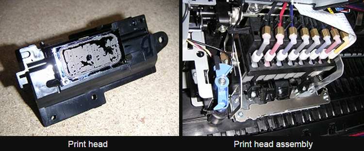

John_Admin 393 Report post Posted May 11, 2015 0020 Print head EOL Just like any other mechanical equipment, a printer requires attention to keep it running smoothly. So, just like when the spanner light illuminates on your cars dashboard so does your printer, but instead of a spanner the error 0020 will appear on your control panel LCD which is informing you that a maintenance procedure is due to be performed. This will involve replacing the print head as the recommended interval has passed. This procedure can be undertaken here at Large Format Repairs for the Epson Stylus Pro 3800 right upto the beast that is the Stylus Pro 11880. Share this post Link to post Share on other sites

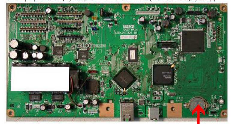

John_Admin 393 Report post Posted May 11, 2015 RTC battery low - Real Time Clock Just like any other mechanical equipment, a printer requires attention to keep it running smoothly. So, just like when the check engine light illuminates on your cars dashboard so does your printer, but instead of a spanner the error 0100 will appear on your control panel LCD which is informing you that a maintenance procedure is due to be performed. This will normally involve replacing the parts which keep the print head clean, hence the error "cleaning unit END OF LIFE" and the waste pads. This procedure can be undertaken here at Large Format Repairs for the Epson Stylus Pro 3800 right upto the beast that is the Stylus Pro 11880. Solution - change the battery. Share this post Link to post Share on other sites

John_Admin 393 Report post Posted May 11, 2015 0001001B Head driver (TG) temperature error Just like any other mechanical equipment, a printer requires attention to keep it running smoothly. So, just like when the spanner light illuminates on your cars dashboard so does your printer, but instead of a spanner the error 0001001B will appear on your control panel LCD which is informing you that there is a problem with the print head. This can be caused by a faulty print head causing an electrical short damaging both the print head itself and the mainboard. This problem can be undertaken here at Large Format Repairs for the Epson Stylus Pro 3800 right upto the beast that is the Stylus Pro 11880. Share this post Link to post Share on other sites

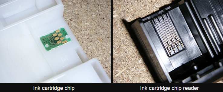

John_Admin 393 Report post Posted May 11, 2015 00010020 CSIC read / write Just like any other mechanical equipment, a printer requires attention to keep it running smoothly. So, just like when the spanner light illuminates on your cars dashboard so does your printer, but instead of a spanner the error 00010020 will appear on your control panel LCD which is informing you that there is a problem communicating with an ink cartridge. This can be caused by a faulty ink cartridge chip or bent pins. This problem can be undertaken here at Large Format Repairs for the Epson Stylus Pro 3800 right upto the beast that is the Stylus Pro 11880. Share this post Link to post Share on other sites
