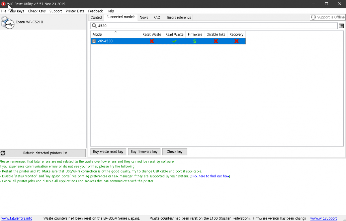

jin 0 Report post Posted February 13, 2020 Hello ~ i have 2 printers one is EPSON WF-4020 , another is EPSON WF4530 these printers can be supported for chipless ? gongcd@hotmail.com Share this post Link to post Share on other sites
John_Admin 390 Report post Posted February 13, 2020 Yes Not supported Share this post Link to post Share on other sites
